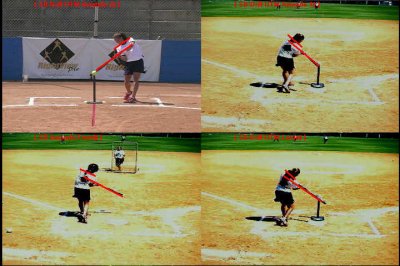

    pic1 Vernon Wells.... notice that the Bat angle / shoulder staying perpendicular to the spine angle... There is your "tilt" as someone mentioned.
    pic 2 & 3

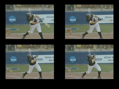

    pic 2... Amanda Freed and Lovie Jung. Shoulder angle and Bat angle are close to parallel.
    Pic 3-4-5 Sequence of swing
    Becky Marx.. Univ of Michigan. Bat head, low through the zone, finishing very high. She is still "inside" the ball. See link below for gif file if this is not working. picture 12
    http://imageevent.com/siggy/hitting/olympic
    Pic 6.... Ortiz Shoulder angle and bat angle parallel
    If you follow the pitch down with your bat head, and keep your shoulders parallel to the swing plane. then everything works like swinging at a pitch belt high... Maintain those athletic angles...

    Exactly!! I referred to it as tilt; bat angle parallel to shoulder angle is a more accurate detail description.
    I believe when "swing level" is the main instruction is where the problem comes in. When one thinks in terms of "level" there is a tendency to visualize the bat parallel to the ground. That would be the case for a pitch at or a little above the hitting zone but the lower the pitch the greater the bat angle/shoulder angle should be.
    Of course, with an improper swing, there will be a lot of sliced hits when bat angle is used. But even that is better than a top-sided ground ball.

    .......... Been following all day. Everything that has been said is true, but CD nailed it.... keeping your angles, bat head and shoulders, your swing should be pretty much the same on any pitch. Stay inside the pitch where ever it is and go after it!
